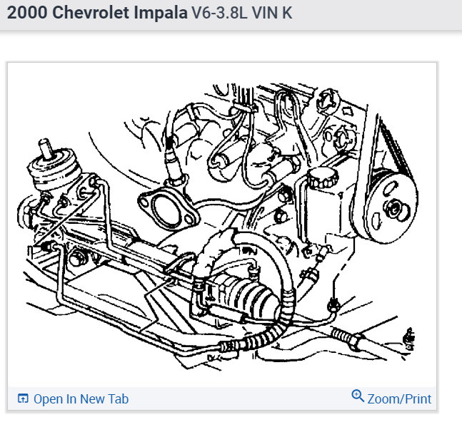

I'm trying to locate the power steering reservoir on my 2000 Impala. Sounds easy enough but on the 3800 motor the reservoir seems to be hidden. I simply want to check the power steering fluid level.

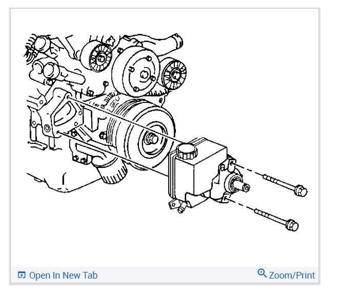

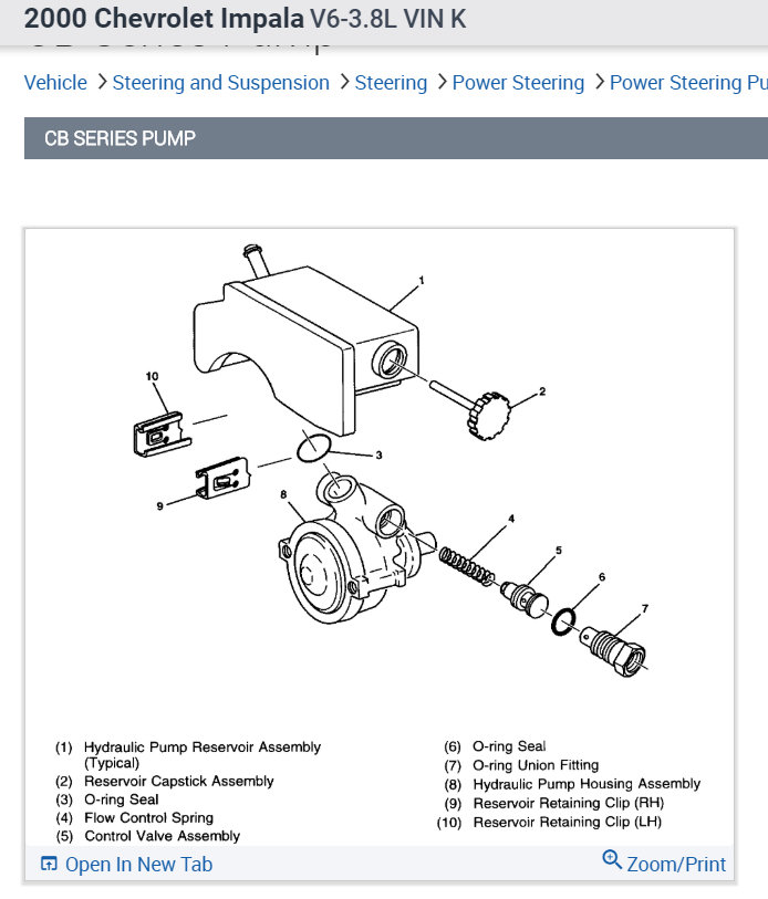

The reservoir and fill cap with the dipstick is on the pump itself. Here are diagrams to help you see what I an talking about below. Check out the diagrams (Below). Please let us know if you need anything else to get the problem fixed.

Thanks for the post! I found it. It's below the alternator and under 2 black hoses. Hard to see especially when all is covered in dirt/grime.
