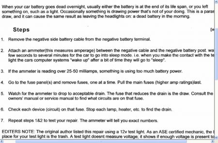

It seems that something is draining my battery when it is just sitting. My brand new battery (which I have had tested and recharged twice) will go dead if it sitts for a few days. I have had my alternator and my starter checked, and I have looked at my connections. But if I let it sit without starting it for a few days, its dead and it doesnt even have the amps to start with a boost from another car. Any ideas?

There's a short circuit in the electrical system that's draining the battery overnite-you sure everything is off within the vehicle. Glove/Trunk ????? etc If so do battery drain test below:
https://www.2carpros.com/forum/automotive_pictures/12900_parastic_draw_1_240.jpg
