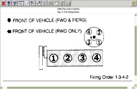

Can you please tell me the firing order and give me a diagram of where wires go on the distribator.
Thank You

2.5L engine
