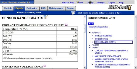

Remember the colder the CTS the higher ohms/resistances. and Vice versus.
Read the sensor before you start the vehicle, then when it gets up to normal operating temperature read it for hot readings. Compare readings w/chart
When you test if for cold and it doesn't give any reading the sensor is bad.
See below chart for your CTS
https://www.2carpros.com/forum/automotive_pictures/12900_1991_cavalier_CTS_values_1.jpg

What scale on the ohmmeter are you using? Base yourself on the chart. Looks to me its out of range.

3.9 is equal only to 3,900 ohms on the 20K scale. You should have more than when the CTS is cold. Then it will start dropping as it heats up.

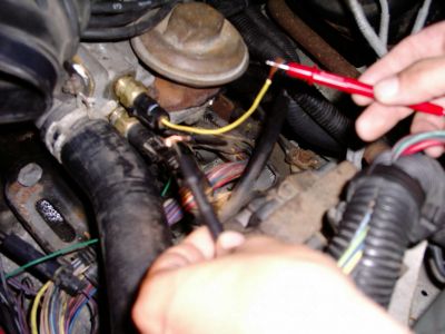

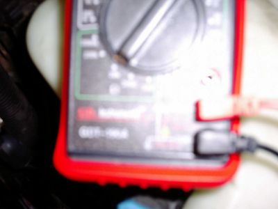

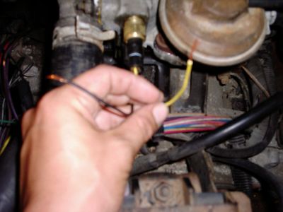

When I did the test it probably was about 50-60 degress today. Just to make sure I am doing things right I added some pics. What you are looking at is the digital meter at 20K, the other pic is the cts which I cut the 2 wires and stripped them so I could take a reading easier instead of trying to get the leads inside the sensor.

What is the reading? I cannot see it the window is not showing.

That is how I got the readings earlier, the cold reading of 3.9 and then the dropping reading after that.
