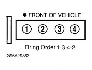

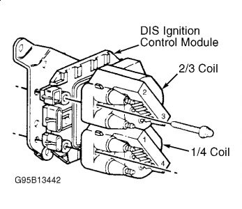

I need a diagram of coil pac firing orer?

Coils are numbered
https://www.2carpros.com/forum/automotive_pictures/266999_cav_3.jpg
https://www.2carpros.com/forum/automotive_pictures/266999_cav_4.jpg
