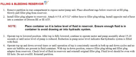

Where is the Convertible Motor on a 1994 Chevrolet Cavalier RS? I think I need to add fluid to it and want to check as my motor is sounding a bit sluggish.

https://www.2carpros.com/forum/automotive_pictures/261618_Noname_2607.jpg
https://www.2carpros.com/forum/automotive_pictures/261618_Noname2_850.jpg
