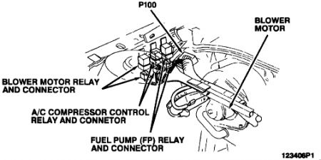

Where is my fuel pump relay located
Friday, August 6th, 2010 AT 1:09 PM
MECHANIC
75,992 POSTS
RH Rear Of Engine Compartment here is a guide to help test it with the location in the diagrams below.
Right hand rear of the engine compartment, behind the right hand strut tower.
