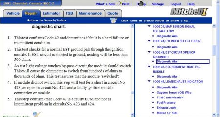

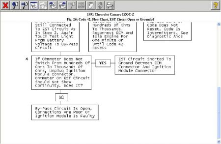

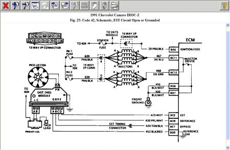

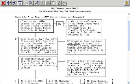

I need to know how to fix code 42 on this chevy 1991 camaro tank you
Wednesday, January 16th, 2008 AT 10:28 PM
2 Replies
MECHANIC
75,992 POSTS
42 Electronic Spark Timing (EST) Circuit
What is it a 305 or 350 CID
+1
Wednesday, January 16th, 2008 AT 10:42 PM
MECHANIC
75,992 POSTS
Here's your diagnostics
Good Luck
