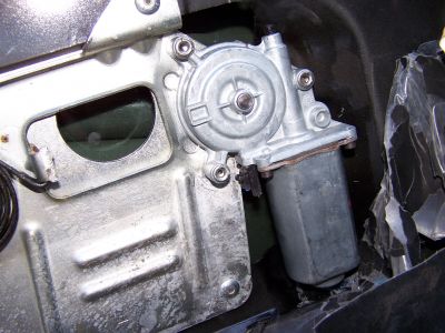

How do I remove and replace this motor please.
Thank you
http://www.2carpros.com/forum/automotive_pictures/259408_Blazer_Window_Motor_2.jpg

You cut those 3 rivits on the motor, but be careful, the regulator is spring loaded and can do some damage to you or someone else. My suggestion is have a professional do this. You can really hurt your self if your not sure what you are doing
