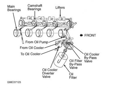

HMAC300
  • 48,601 POSTS
You seem to misunderstand me . I'm including a pic of the oil system. where it says oil cooler bypass valve there should be a plug in teh block above the cooler lines. you should be able to hook up there and there should be a plug there as it goes to an empty hole. If your truck still runs and you don't get any lights going off on your dash saying low oil pressure and your engine still runs it will probably be the gauge that is bad. it cold be losing ground or just plainn not any good.... here is the pic and i hope you can understand where it is....

CHIEFCATCHEMALL
  • 17 POSTS
Im still not really understanding where it is.I did notice and oil leak under my engine. Its not under the pan or anything. Just a small spot. Been getting that for the past few mornings.

CHIEFCATCHEMALL
  • 17 POSTS
I found the plug your talking about by the oil filter. Wont come free though. Soaked it in liquid wrench and started wrenching. Cant get it off. Taking it to the garage in the morning. Is a small oil spot under your engine a sign of a bad sending unit? Never had it before. Whats the cost to replace a gauge, sensor, or sending unit usually hmac?

CHIEFCATCHEMALL
  • 17 POSTS
Youve got all the tricks in the book dont ya? HAha thats clever. I just got it back today. They replaced the oil pressure relief valve. Drove it for an hour straight hard. Now when its completely warm and I come to a stop its reading right around 25psii. And when I am accelerating its anywhere from 45-55 psi. Cant seem to get it to go below 25 psi anymore. Jeeze did I get lucky? It seems like if I really was running it on 0psi (granted I never really drove far on 0) I would have ruined my engine.
