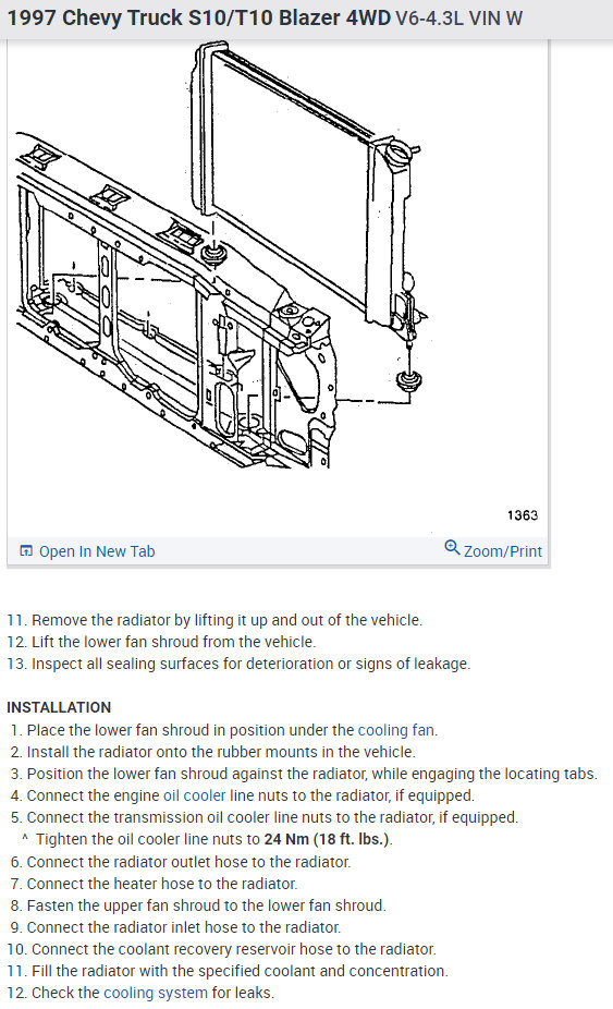

How do I replace my radiator
NOSIDE31
  • 1997 CHEVROLET BLAZER
  • 6 CYL
  • 4WD
  • 210,000 MILES

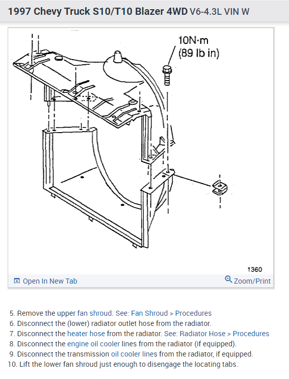

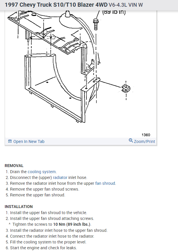

How do I replace my radiator the engine is a vortec
Friday, July 25th, 2008 AT 6:32 PM
SQM
  • 6,383 POSTS

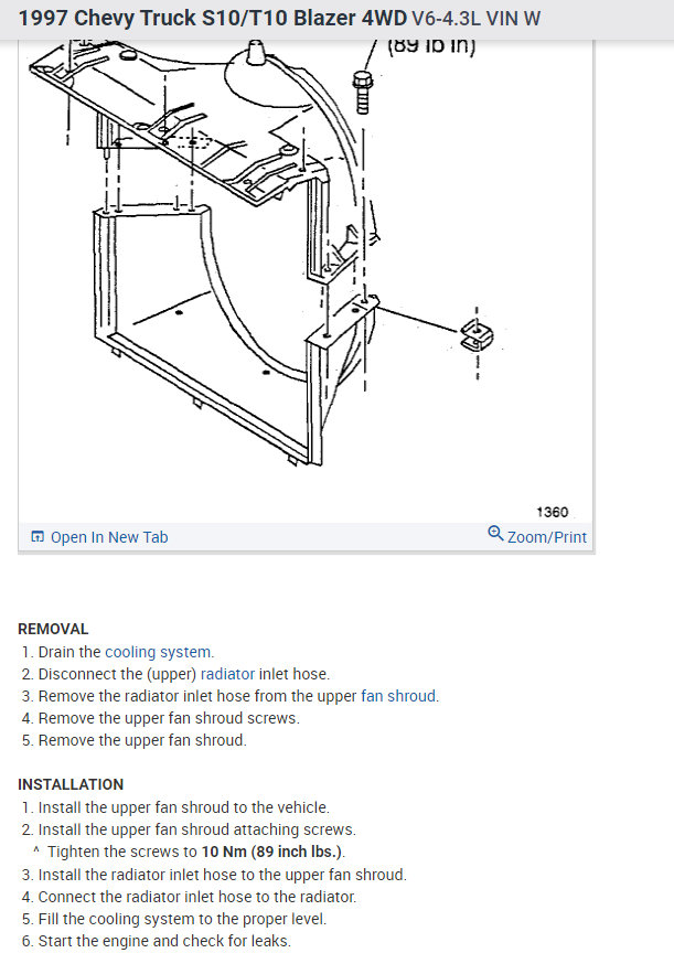

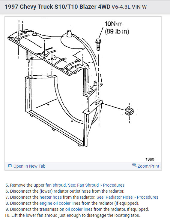

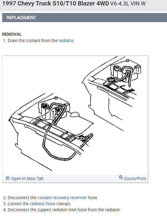

Replacing the radiator can be done using simple hand tools.
First make sure the engine is cold before getting started.
Take off the radiator cap and drain the coolant.
You will also have to remove the cooling fan shroud.
Here is a helpful article:
https://www.2carpros.com/articles/how-to-replace-a-car-radiator
