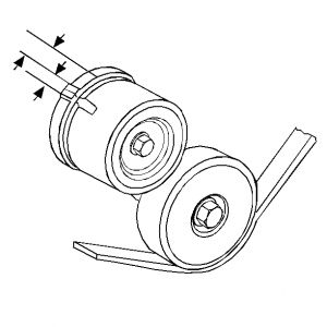

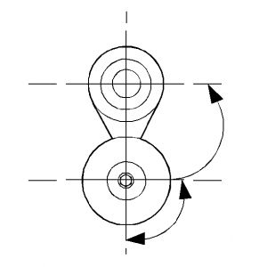

Im atempting to replace my alternator. Problem I am having is how to take off the belt. I know there is a belt tentioner, but not sure how to find it. Do you have an engine diagram, or can you direct me to where this is in order to remove the belt?

Removal Procedure
Notice: Allowing the drive belt tensioner to snap into the free position may result in damage to the tensioner.
Use a  -inch breaker bar with a socket placed on the tensioner pulley axis bolt and rotate the tensioner to the left (counterclockwise).
Remove the Accessory drive belt.
Installation Procedure
Route the drive belt over all of the pulleys except the tensioner. Use a  -inch breaker bar with a socket placed on the tensioner pulley axis bolt and rotate the tensioner to the left (counterclockwise).
Install the belt over the tensioner pulley.
Check the belt for good tracking around each pulley.
Allow the belt tensioner to relax.
