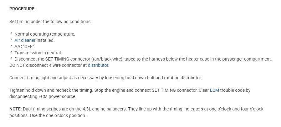

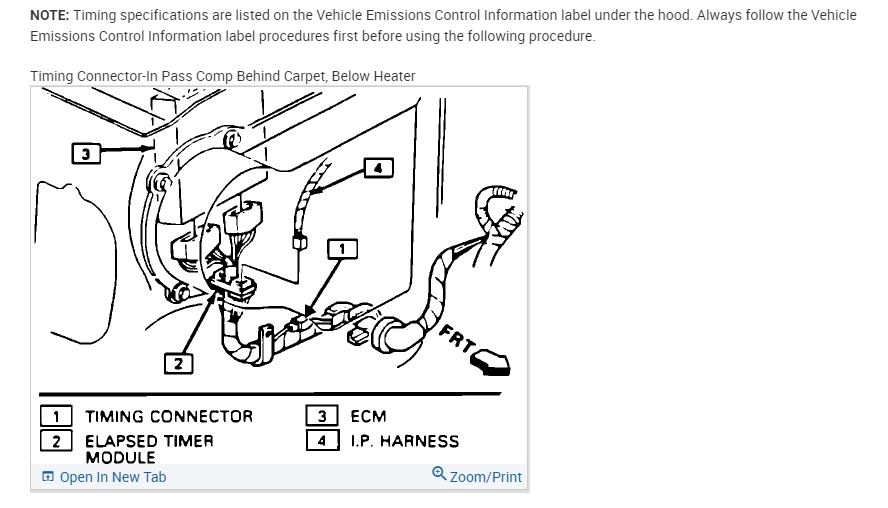

Can you please tell me if I need to use a tachometer along with the timing light to set the timing on my truck?
Tuesday, February 2nd, 2010 AT 1:11 PM
MECHANIC
52,796 POSTS
Good morning,
No, you do not need a tachometer. You just need to have it at hot idle and follow the procedure. I attached the procedure below for you to follow.
Let me know if you have any other questions.
