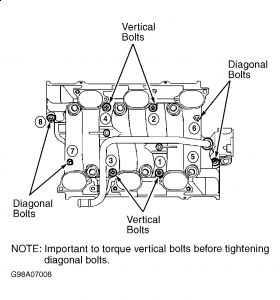

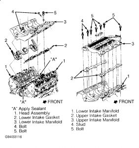

How hard is it to change a intake gasket on this car and any one got a diagram for it
Friday, November 6th, 2009 AT 1:03 PM
MECHANIC
110,192 POSTS
I don't have a guide, but it is a straight forward job and very common on the 3.1L.
Here is an exploded view of the intake. Following that is the torque sequence when replacing it.
