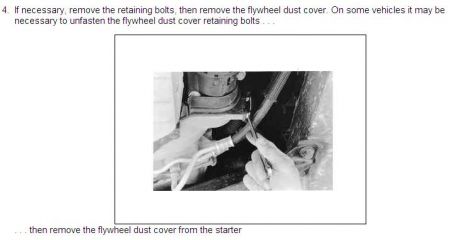

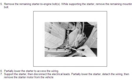

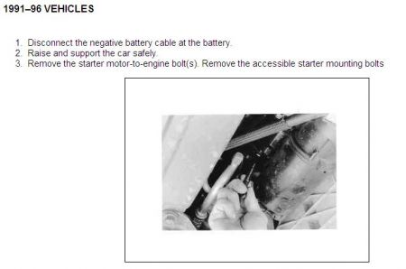

How do you replace the starter? Where are the bolts located?
