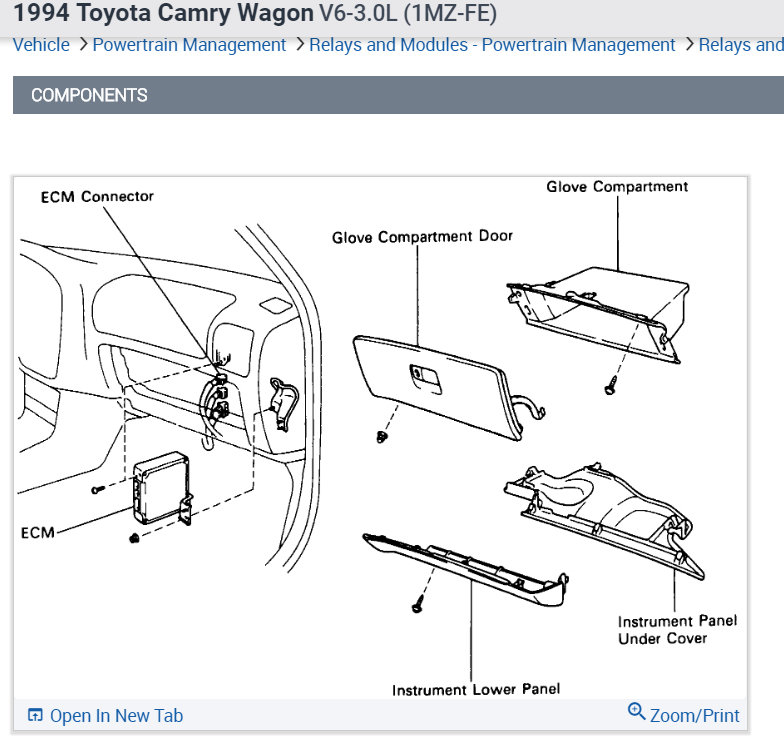

It sounds like the ECM had gone bad I would try to get a used one and plug it in here is the location.

Okay so I bought an ECM from junkyard I pulled it. 1994 Camry same make.
The car appears to be okay. No check engine light. However I will know for sure if it goes all day tomorrow without going on. I do notice something different though.
When starting car, it starts right up but the rpm goes past 1 then levels down to just under 1. Before this I believe it just went to under one not sure? I bring this up because I do know for a fact before change when I turn steering wheel (in park) the idle changed slightly. Now it does not.
So while no light and appears be driving okay the idle is different maybe better I do not know if it is normal now or was before.
