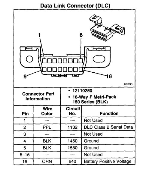

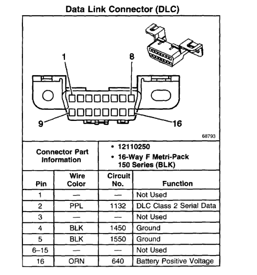

Where is post a and b on my diagnostics?

Good afternoon.
Can you be more specific on what you mean?
Do you mean the data link connector?
Image (Click to make bigger)
