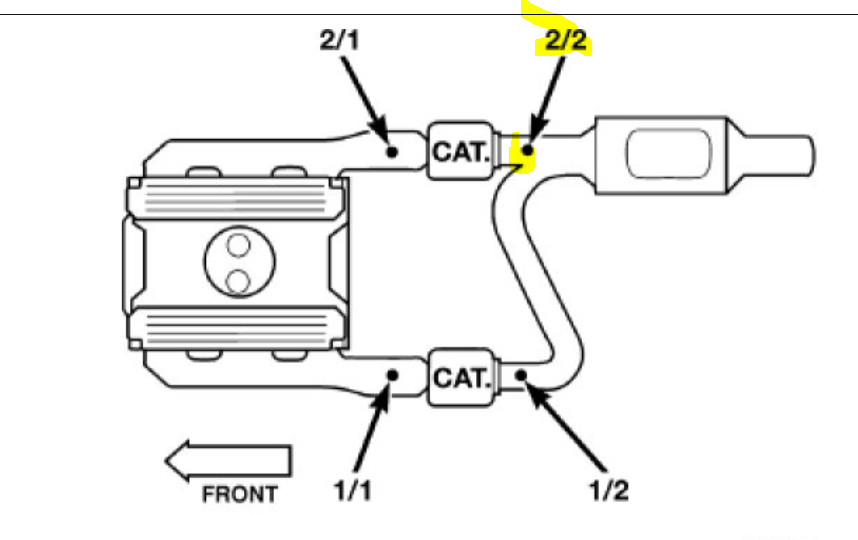

My check engine light came on and the garage said it was the o2 sensor on the passenger side. After he replaced it and I drove it around for 2 days and the light came back on. I have no problem starting it and runs good. What could be the problem?

The idea that it runs good indicates it could be a few different causes. The light itself could indicate an EVAP leak, and it would still run good.
If the code that was retrieved was related to an oxygen sensor, the sensor could be the issue (which was replaced) or it could be a wiring or an electronics issue.
By chance, do you know the code that was retrieved that led to the replacement of the sensor? '

I found out the code, P2098 is the code and there were no other codes.

Thanks, that helps. The code doesn't indicate a faulty O2 sensor. Instead, it indicates a lean fuel mixture on that bank 2.
There are a few things that can cause this. For example, a faulty sensor that has already been replaced, an exhaust leak at the exhaust manifold, a wiring-related issue, and so on.
Oftentimes, a lean fuel mixture is the result of a weak fuel pump or an engine vacuum leak. In this case, however, only one side of the engine is being affected, so those two things are very unlikely.
By chance, do you have an exhaust leak close to the engine? It may simply sound like a ticking. Since it is one side, this would be my first suspect or the wiring to the sensor is corroded or damaged.
I attached a pic below highlighting the sensor in question. It will be after the catalytic converter. When the engine is cold, follow the wiring from the sensor to where it connects to the wiring harness. See if there is any evidence of damage. Disconnect the connector and see if there is corrosion in the connector or damaged pins.
Let me know what you find or if you have questions.
See pic below.
