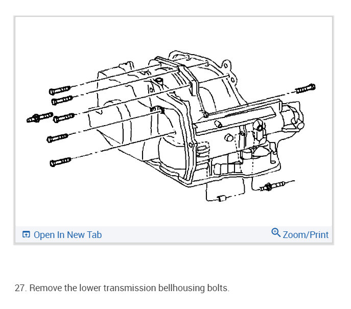

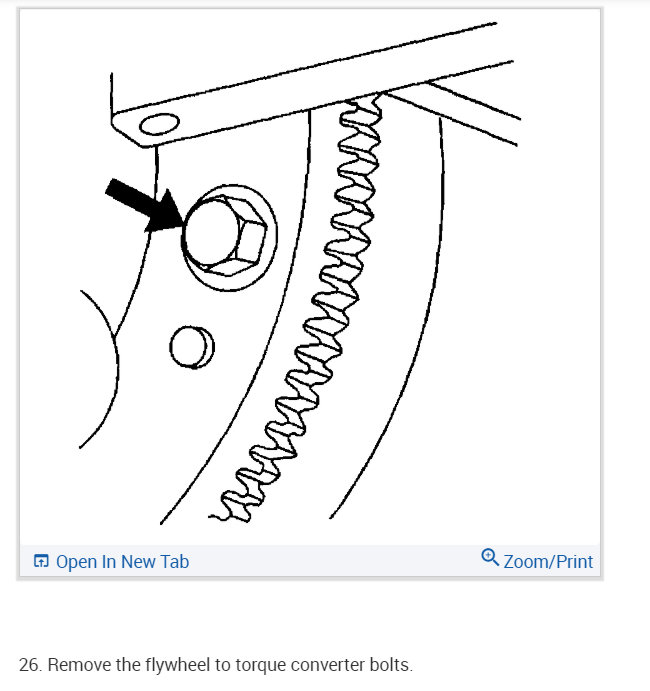

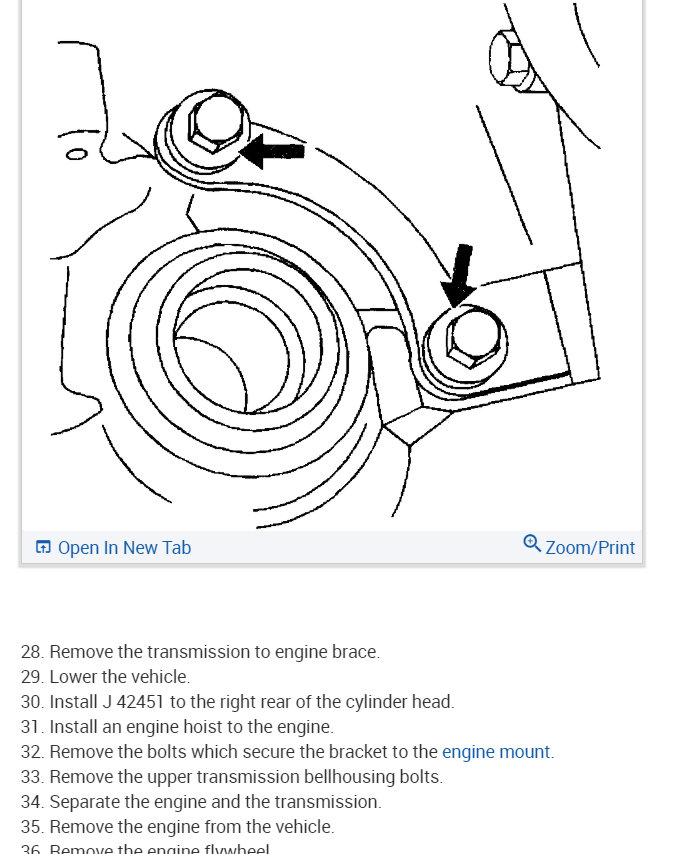

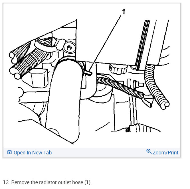

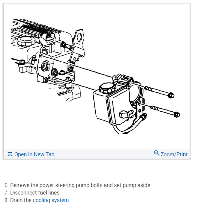

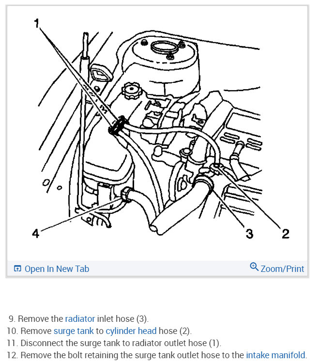

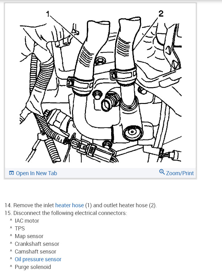

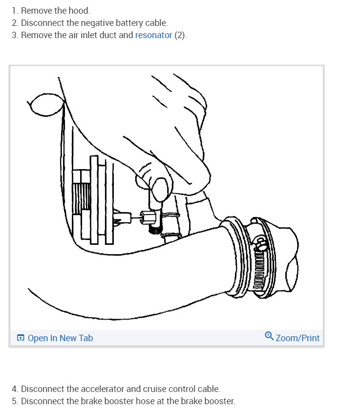

Do i have to remove the axles and where are all the bolts that connect the transmission and the engine. i am not taking transmission out and it is being removed from top.

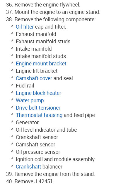

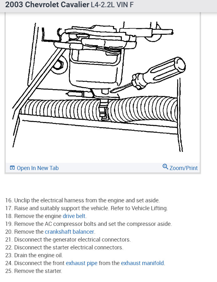

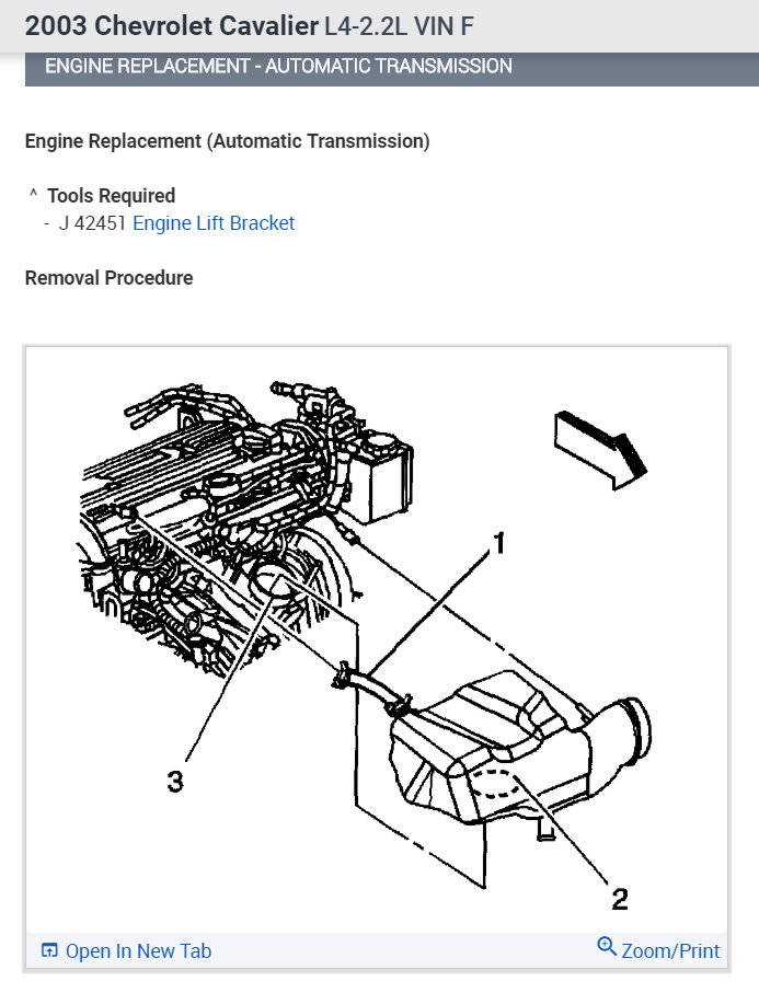

I would start by draining the coolant and disconnecting the battery. Here are the complete instructions on how to remove the engine from your car in the diagrams below which show the bolts you need to remove. Please let us know if you need anything else to get the problem fixed.

Where are the engine lift points so I can pull it through the top.
Aug 7, 2019 at 3:53 AM
  • 54,144 POSTS
There should be hooks on either side. the factory uses to install the engine those will work good. Can you please shoot a quick video with your phone so I can see if there are still there?
