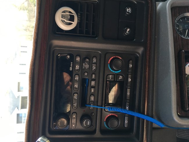

Can you please send me a picture of your radio head unit?
We need to work out if you have an amplifier fitted.
Then we can work out if it's an issue with the amp or the radio unit.
Regards, Joe
Wednesday, March 20th, 2019 AT 3:40 PM
KELTICTIM
  • 7 POSTS
I’ve sent a picture multiple times. It’s a standard head unit with tape, CD, 5 disc changer down below, and RSE for the DVD player. Bose speakers, and I believe an amp.

Here is the picture:

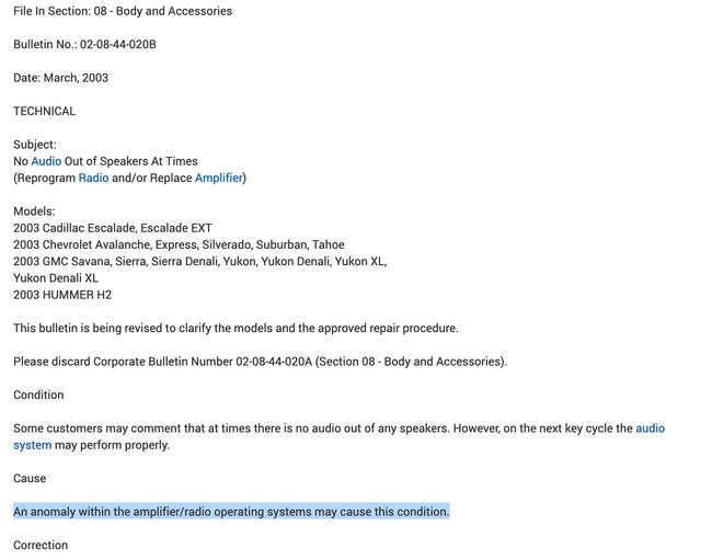

It looks like it may be a radio programming or amplifier issue.
There is a TSB applicable to your vehicle.
I would Advise going to a Cadillac dealer if you can, they will be able to identify your sound system from the VIN and tell you what measure is applicable to your vehicle.
If you need to replace the amp you can do this yourself but the programming update you may need the dealer to do for you.

Replacing the stock head unit with aftermarket and deleting the amp would rule out these causes yes.
You will need to access the amp to cut and reconnect the speaker wires so they no longer go through the amp to do this.
If you then still had an issue you would be looking at an intermittent wiring issue.
In terms of saving time this may be a good way to go if you don't mind getting rid of the stock equipment. Whether or not it will be cheaper than replacing the stock amp if needed and reprogramming I am not sure.
I would still recommend asking the dealer as to what the TSB repair would be. It may just be programming. It should not cost anything for them to advise you on this and give you a quote.
