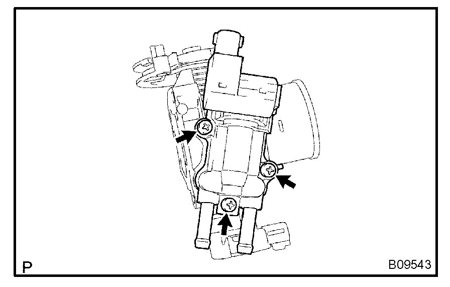

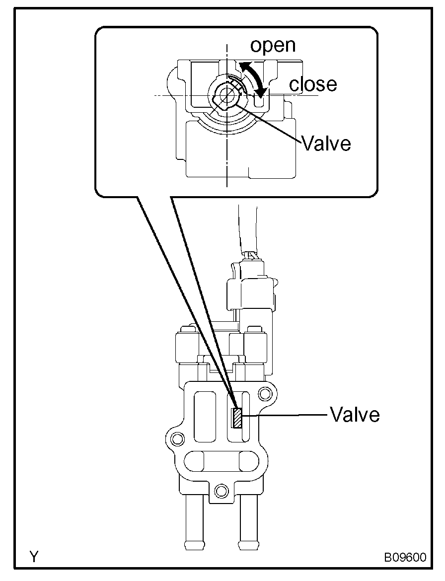

Here are directions specific to your vehicle to testing or replacing the IAC. The attached pics correlate with the directions.

pic 1
1. REMOVE THROTTLE BODY
2. REMOVE IAC VALVE
Remove the 3 screws, IAC valve and gasket.

INSPECT IAC VALVE OPERATION
pic 2
a. Check that the IAC valve is half open.
b. Connect the IAC valve connector to the IAC valve.
c. Disconnect the ECT sensor connector from the ECT sensor.
d. Turn the ignition switch ON.
e. Check that the IAC valve moves.
HINT: Repeat connecting and disconnecting of IAC valve connector several times and check the operation of the valve.
If operation is not as specified, replace the IAC valve.
f. Turn the ignition switch OFF.
g. Connect the ECT sensor connector to the ECT sensor.
h. Disconnect the IAC valve connector from the IAC valve.

Turns out it does require removal of a pair of coolant hose from the throttle body and lost about an inch off the full line on the coolant reservoir. Took me about 4 hours to finish everything. First, I removed both of the hoses which one of them has rust underneath it, then took out the 3 screws which was also stuck hard, did some hammering and WD40-ing. As inspected, the valve did not rotate freely so i gave it a good clean with some throttle body cleaner and the valve was rotating a lot smoother. Will give it some time to see if the hesitating persists but so far after test driving, it was all fine.
