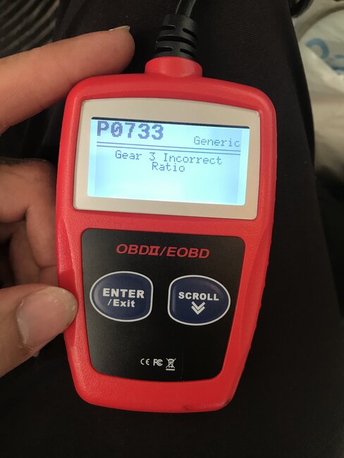

The car was running fine until this morning, it slipped into third gear and the neutral light started to blink. The transmission fluid looks to be at the appropriate level, had it changed about a month ago. Checked the A/T control relay and that’s working fine. The wiring looks ok, just dirty. Giving me the code P0733 on the reader. Could it be the TCM or is it more probable to be internal transmission issues?

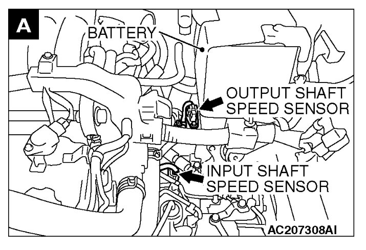

This is common when the input shaft speed sensor is going out, this will not leave a code, here is the location so you can change it out. Also here is more information on the code:
The P0733 trouble code means that the Powertrain Control Module (PCM) has detected that the actual gear ratio in third gear does not match the expected ratio.
Check out the images (below). Please let us know how it goes

Unfortunately, this did not fix the problem. I switched out the input shaft sensor today and same thing happens. Goes into limp mode when attempting 3rd gear. Even in manual it will not go past 2nd.

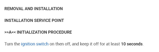

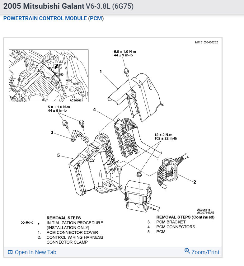

Can I ask if the speedometer works? I have seen the PCM go out and cause this issue as well. FYI. If the transmission fluid is not burnt this can be the problem. You can send the PCM out to have it checked by searching Google or Ebay for a service that can help you. Check out the images (below). Please let us know how it goes.

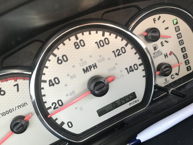

DANNYF623
Thanks again Ken!
The speedometer fluctuates, sometimes I’m going about 55 MPH, but the speedometer reads 40 MPH, other times I’m stopped at a light and it reads 20 MPH. This picture below shows an example of it in park.
Jul 24, 2023 at 4:06 PM
  • 54,144 POSTS
It sounds like the PCM, or instrument cluster is not working correctly, we better do a CAN scan, you can get a CAN scanner (Controller Area Network) which will work on most cars from Amazon.
