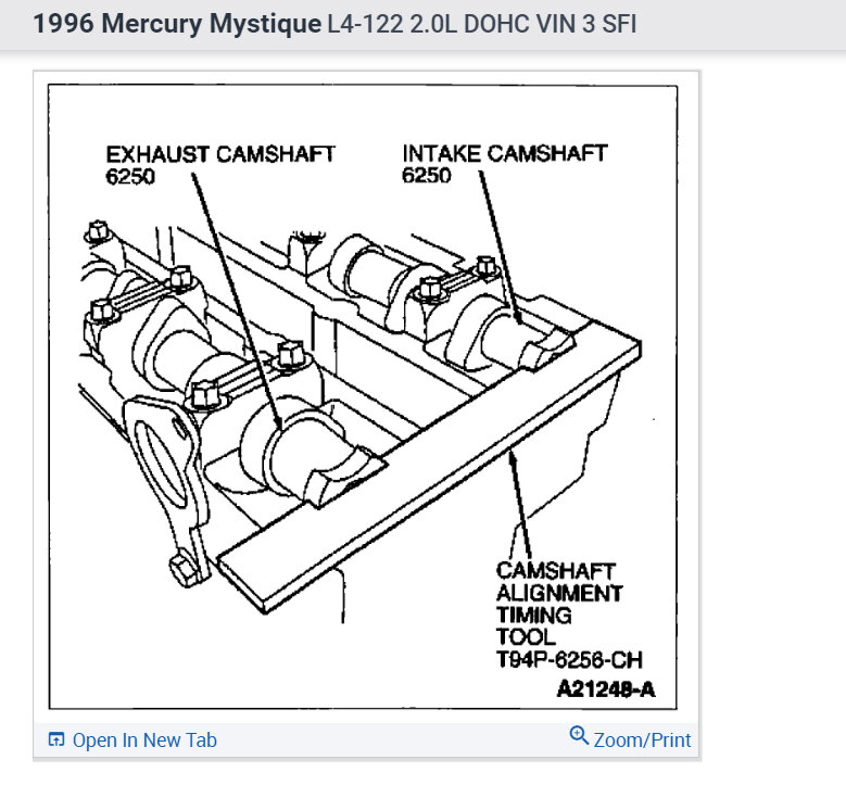

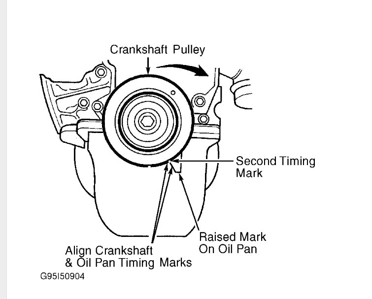

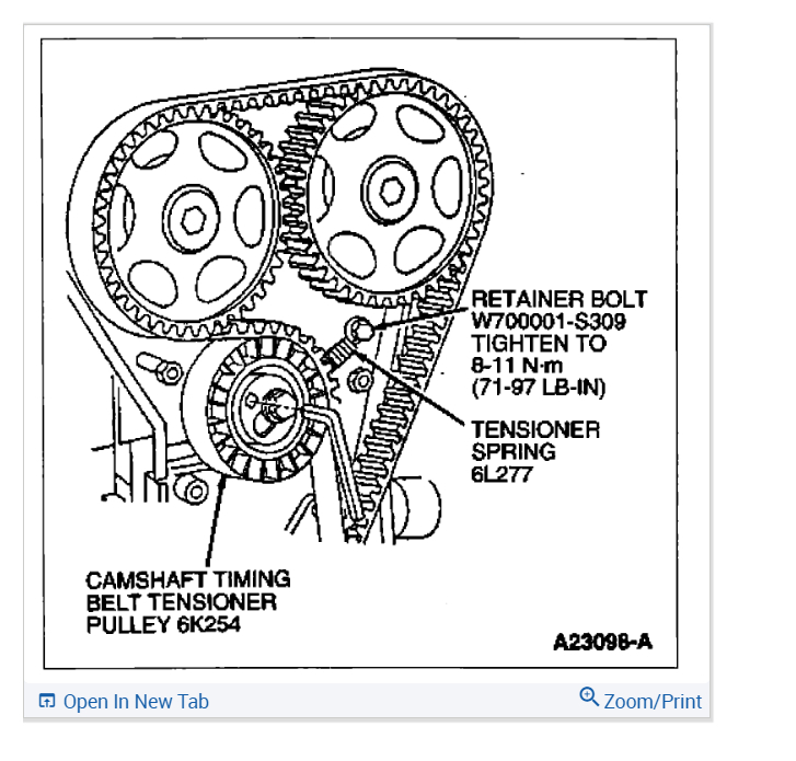

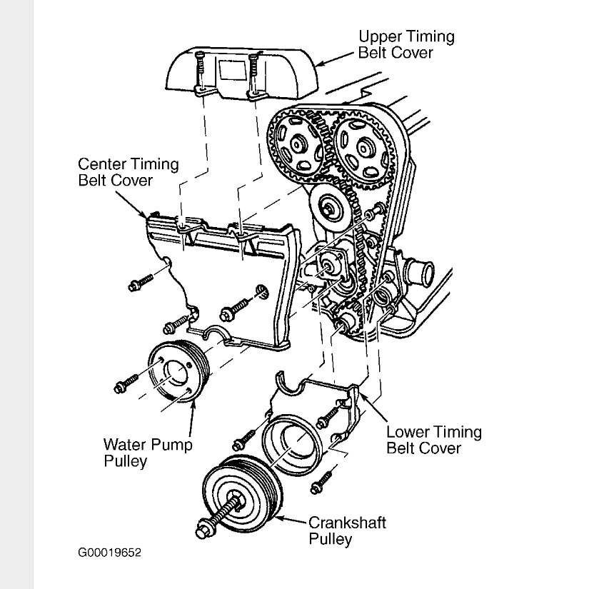

If the timing belt was loose the engine could have jumped time so when you sprayed starting fluid it ignited inside the intake causing the damage, you have described. I would recheck the timing belt marks which I have included in the images below. Also, if you can upload an image of the airbox I can help you determine if it can be repaired. Check out the images (below). Please let us know what happens.

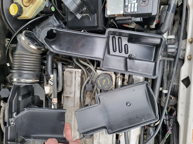

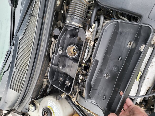

It broke pretty clean.
Mar 23, 2023 at 5:50 PM
  • 54,128 POSTS
Yep, that came apart pretty good, I would try some epoxy to glue it back together make sure there are no holes and that the part is airtight. Also any luck with the timing belt?
