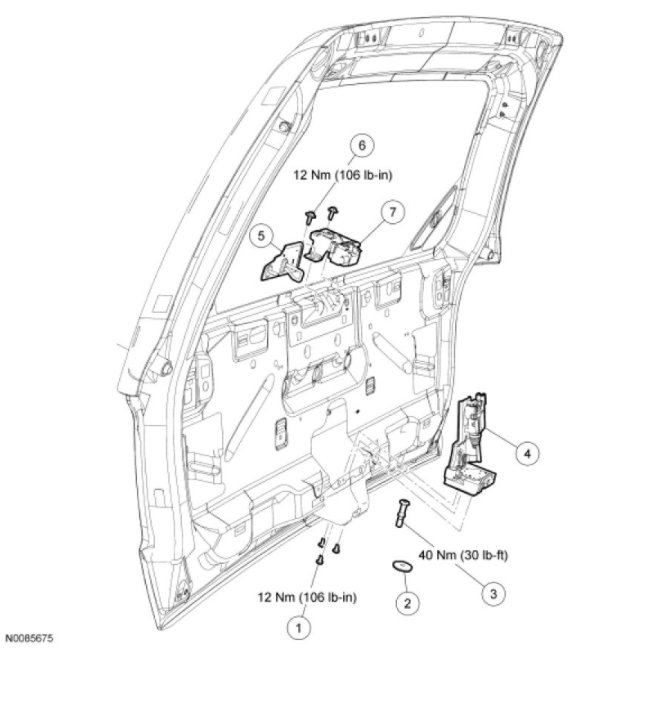

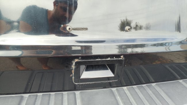

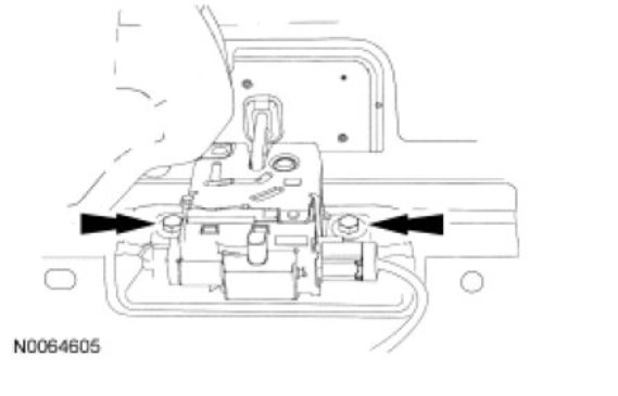

Hi there,
I have seen tons of videos on the upper portion but can the rear handle in the picture below be replaced?
Thursday, October 12th, 2017 AT 6:41 PM
KEN L
  • MASTER CERTIFIED MECHANIC
  • 55,404 POSTS

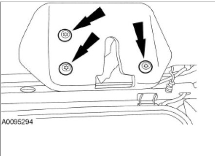

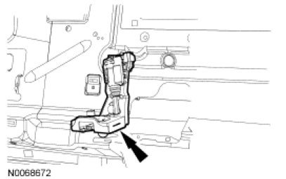

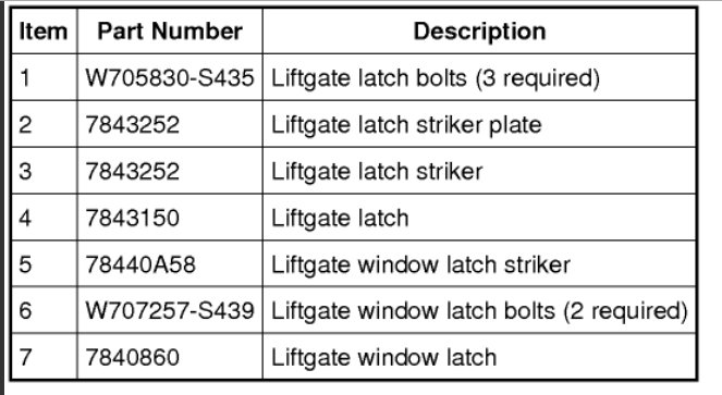

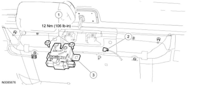

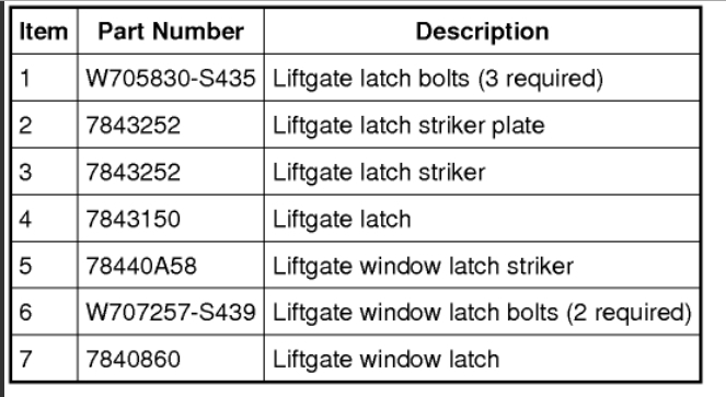

Yes you can replace the handle, but you must remove the inner panel.
Here is a guide that we give you an idea of what to do:
https://www.2carpros.com/articles/door-panel-removal
Here are some diagrams I found that should help you see what to do (below).
