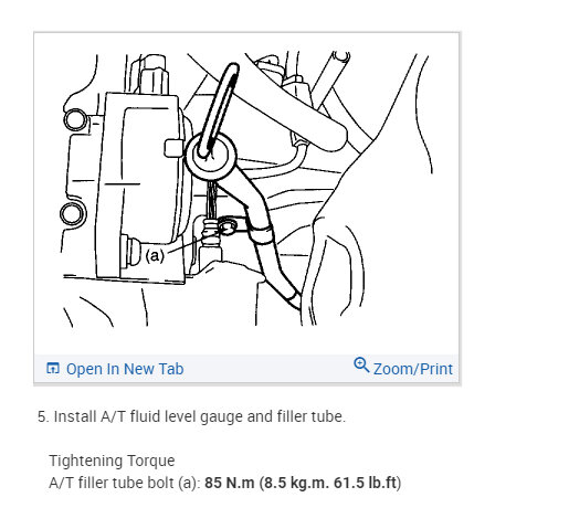

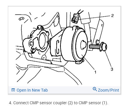

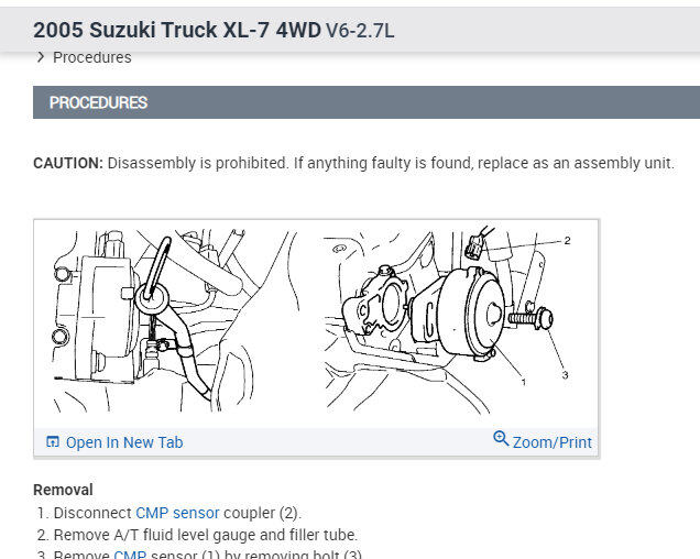

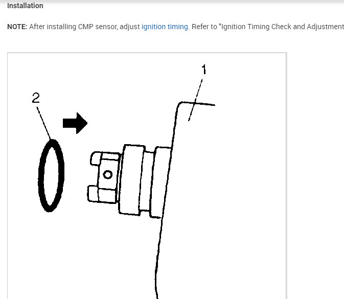

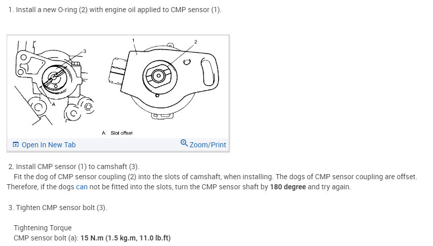

Camshaft position sensor location needed. Please, thank you.
Friday, January 27th, 2023 AT 12:42 PM
MECHANIC
110,194 POSTS
The sensor is located right in front of the transmission dip stick tube. See pics below.
The pics below are for the removal and replacement of the camshaft position sensor. Let me know if this helps or if you have other questions.
