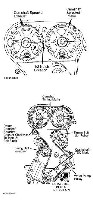

BLUELIGHTNIN6
  • CERTIFIED EXPERT
  • 16,542 POSTS
what is the 8th digit of your VIN?
Oct 29, 2019 at 6:26 PM (Merged)
HOLLAND HILSCHER
the letter you need is a x
BLUELIGHTNIN6
  • CERTIFIED EXPERT
  • 16,542 POSTS
https://images.2carpros.com/forum/automotive_pictures/261618_Graphic_673.jpg

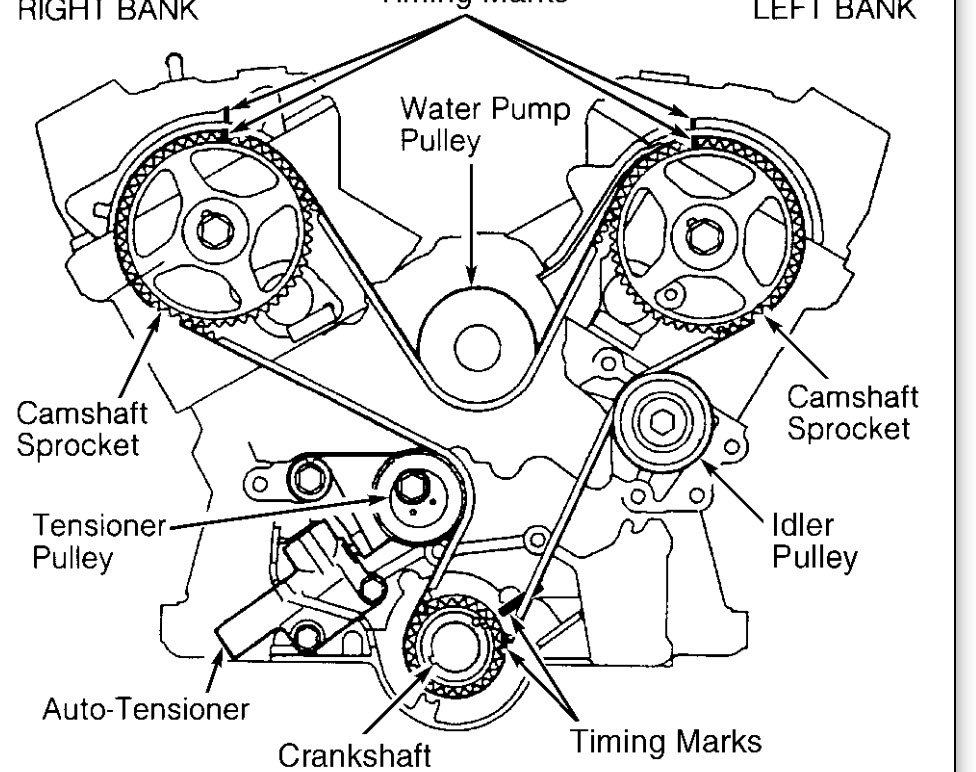

BTTYBEAL
I need to know how to set the timing belt on this car.
MHPAUTOS
  • CERTIFIED EXPERT
  • 31,937 POSTS
Hi there, Engine timing belt set up as per pic. Mark (mhpautos)

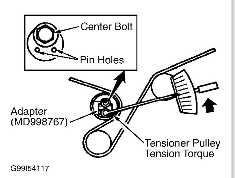

once you get cam in place you may need to lock it down so it does not move. also, this is an interference engine so do not turn engine over while belt off. See special tool picture.

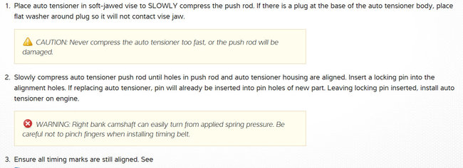

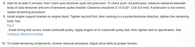

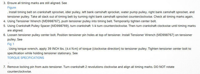

see pictures for diagram left hand side must be done first then force oil from tensioner and lube chain with engine oil prior to install. also either rent a manual from here or buy one so you do not install it wrong it is a lengthy process.
