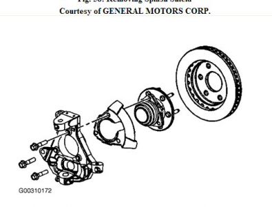

You pretty much have to pull everything apart. You will have to take the axle nut off first before you taek teh wheel off. otherwise you won't be able to loosen it. You didn't say front or rear, so i'm sending the front, next time let us know. Here is the front, the rear is similar.....

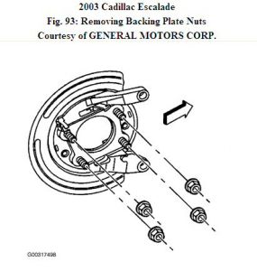

Most guys won't answer your post because all it says is rear dust brake shields. I ncluded a pic showing the shield and where they are located. It should be pretty simple that everything ahs to be disassembled to get them off. That is why the pic is included. Obviously you need t take this to a pro so you can instill what you want done.

https://www.2carpros.com/forum/automotive_pictures/406719_backing_plate_removal_1.jpg
https://www.2carpros.com/forum/automotive_pictures/406719_backing_plate_1.jpg
i think this pic will be closer to what you need.. make sure to retorque everything
