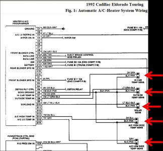

This part is no longer carried or made by GM, I was able to locate one of these parts, I am now e=being told that two of thses parts are required to repair my car. Something to the effect of a low and High temp thing. All of the diagrams I have seen only show one of these sensors in the system. Please confirm the requirement for 2 ea and any leads or after market part number you may know of.

Back to the orginal question.
Is there a requirement for two each refrigentant temp senors on a 1992 Cadillac Eldorado touring coup with a 4.9L engine. Any diagram I have seen only calls for one ea per system. I am being told by a repair facility that the system requires two each of these sensors.

Hello -
Thanks for the info. . .. . .. . ...
I hope you can see the pic. . .. . .actually there are 5 sensors. . .. . .in car temp sensor, outside temp sensor, solar sensor, A/C high side temp sensor, and the A/C low side temp sensor.
https://www.2carpros.com/forum/automotive_pictures/248015_1_177.jpg
They all feed into the Heater/A/C programmer. . .. . ..
Again, please tell me exactly what the vehicle is doing.

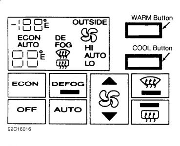

ACP SELF-DIAGNOSTICS
NOTE: Operating vehicle in SERVICE MODE for extended time periods without engine running will drain battery, possibly causing system to give false diagnostic information. If vehicle is to be operated in SERVICE MODE for more than 30 minutes, connect charger to battery.
Entering SERVICE MODE
1. To enter SERVICE MODE and self-diagnostics, turn ignition on with engine off. Simultaneously touch OFF and WARM buttons on Climate Control Center (CCC). See Fig. 2 .
2. Hold buttons until a segment check is displayed on Instrument Panel Cluster (IPC). This should take about 3 seconds. If any segments of IPC do not glow, replace display.
NOTE: In SERVICE MODE, PCM, ACP, IPC and Supplemental Inflatable Restraint (SIR) system can be tested. Only information relating to A/C diagnostics is given in this manual.
https://www.2carpros.com/forum/automotive_pictures/248015_F2_7.jpg

You have a high temp and a low temp sensor in the system. They are both the same parts, and replacing one does not mean you need to replace the other. They(GM) must have discontinued them within the past couple months. I don't have a part number for the sensor, or the harness connector with leads. The latter is on my bench at work.
