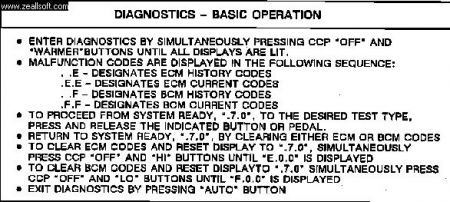

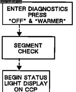

I have a 1988 Cadillac Sedan Deville which has both the stop engine and service now light on. What do I need to check.

read codes
