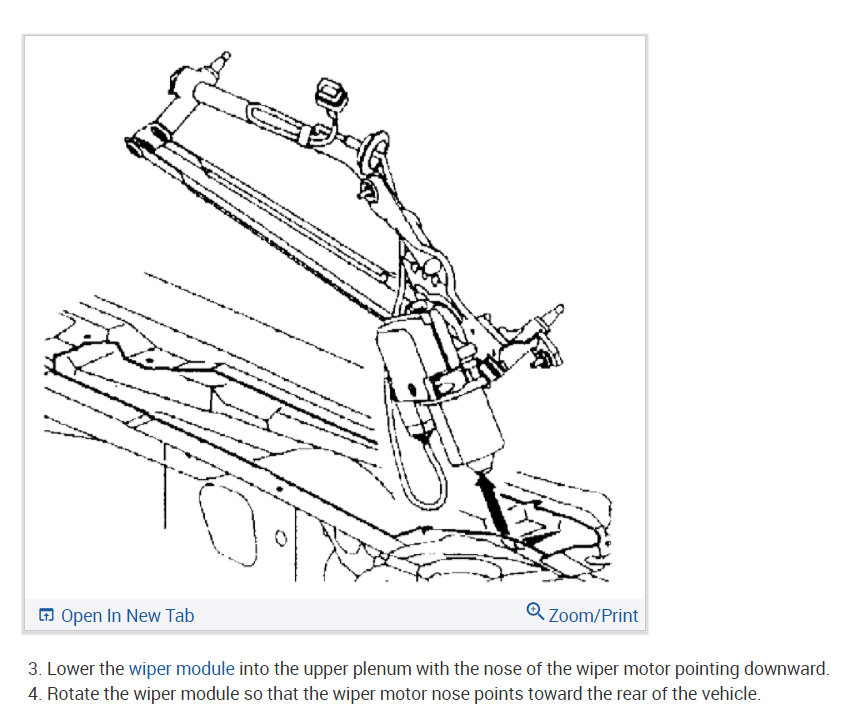

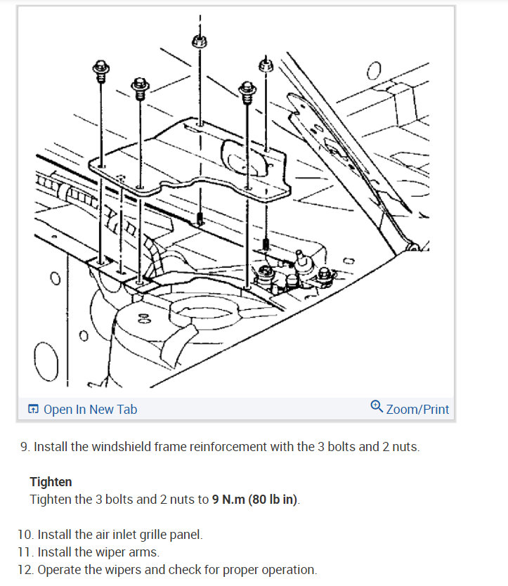

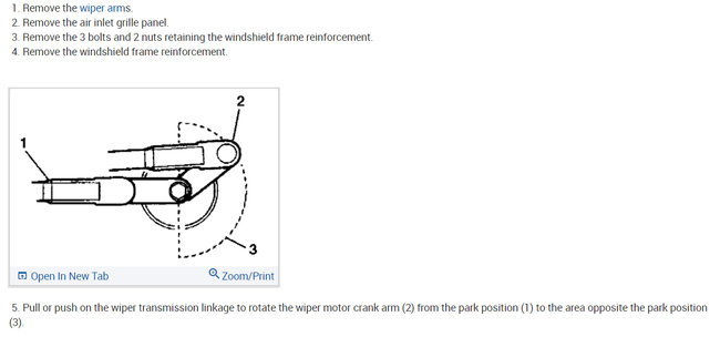

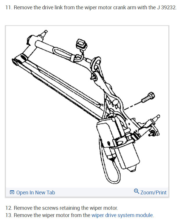

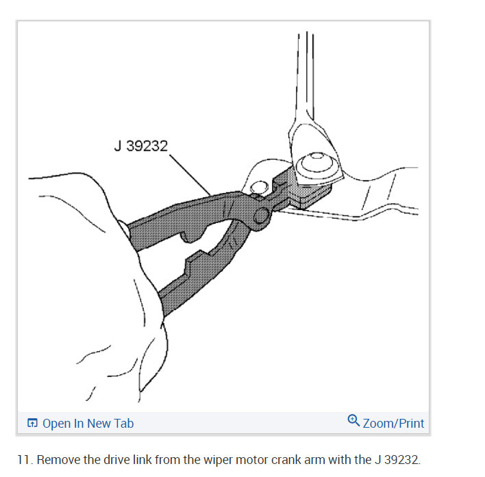

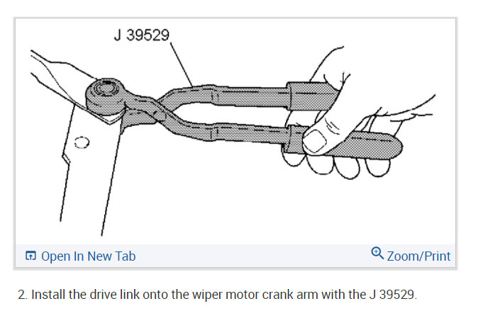

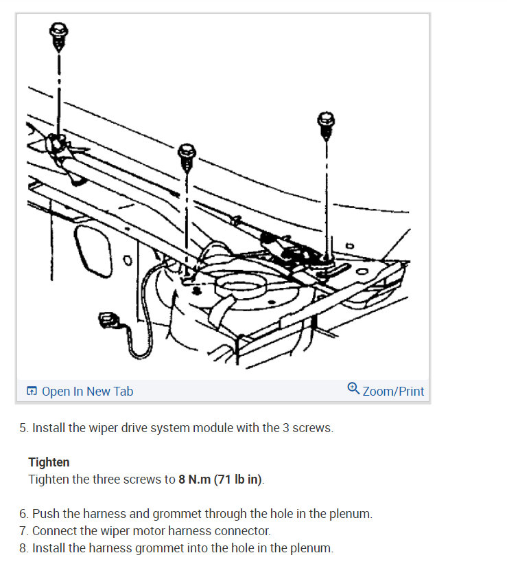

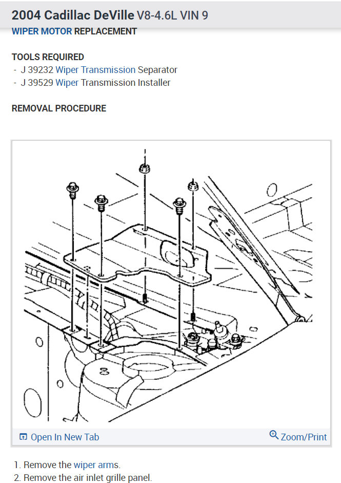

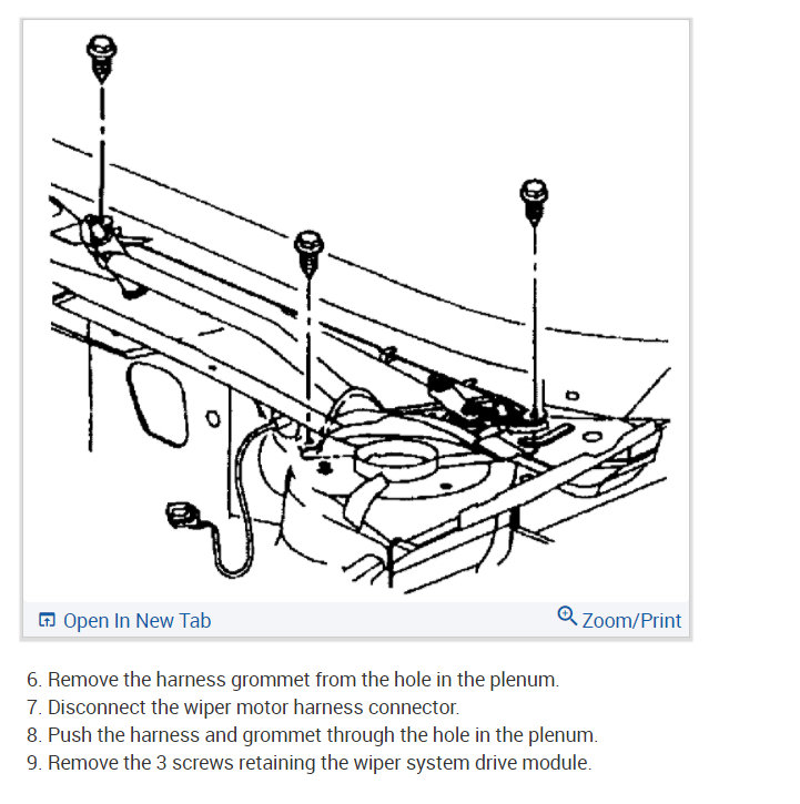

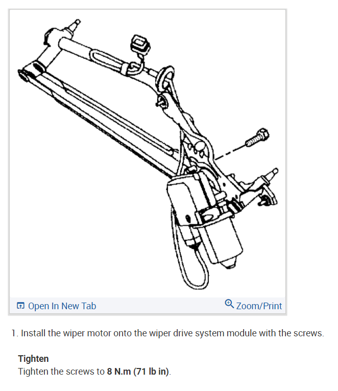

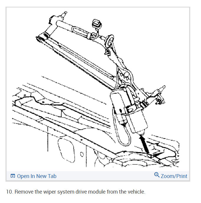

It is common for the wiper module to go out on these cars here is its location so you can change it out. Check out the diagrams (Below). Please let us know what happens.

Thank you. The new module and motor fixed it.

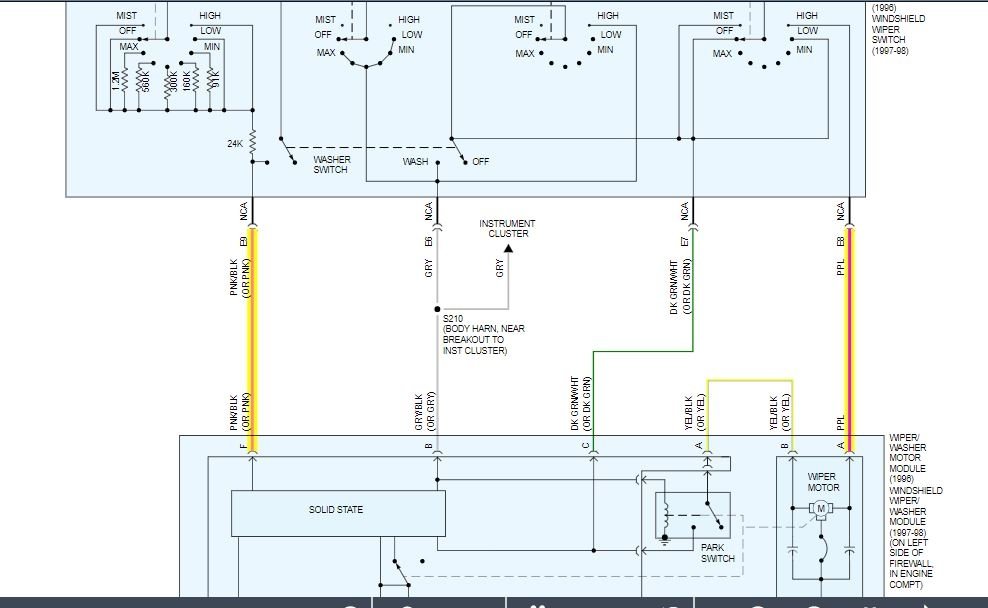

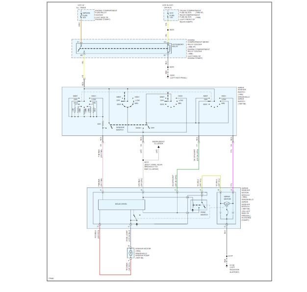

  • 52,797 POSTS
Good morning,
Check the two wires I highlighted in the attached diagram.
The purple wire should have voltage with the wiper in high-speed mode. The other highlighted wire should have voltage at the lower speeds.
Thursday, November 12th, 2020 AT 11:17 AM (Merged)

  • 52,797 POSTS
No such module.
The controls are inside the wiper motor itself.
Do the voltage checks and get back to me.
+1
PAULA SOTO
Tried the two wires no power from either wire. Tried connector that's on side of wiper motor, no power.

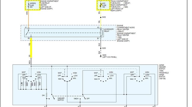

  • 52,797 POSTS
Okay, check the yellow wire at the wiper switch. There needs to be power from the accessory relay.
Also, check both fuses listed for power on both sides with the key on.
