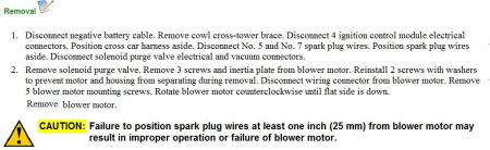

the blower motor was taken out when I had the engined replaced. Now that the new engine is in I can't squeeze the blower back in past the valve cover or can i?

Now that engine is in place you will need to use steps below in reverse order to install new blower motor.
https://www.2carpros.com/forum/automotive_pictures/261618_Noname_2727.jpg
https://www.2carpros.com/forum/automotive_pictures/261618_Noname3_323.jpg

Just drop the sub frame and install it
