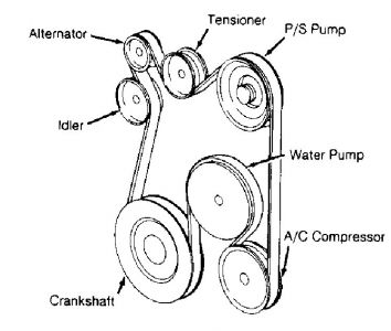

How do I put an serpentine belt on my engine. I need indtructions on how to put it on.
Friday, March 21st, 2008 AT 4:49 PM
SERVICE WRITER
  • 9,123 POSTS
4 cylinder huh?
PAy attention to the belt routing:

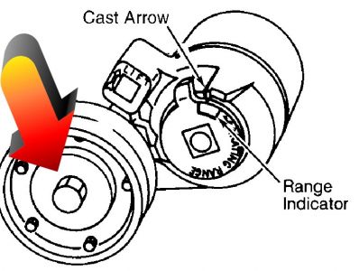

Pull back on the tensioner pulley nut to release the tension, slip off the belt while the tension is off. Istall new blet in the right position, pull back on the tensioner and slide belt all the way on. release tensioner.
