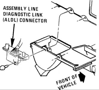

Where is the obd1 plug located?

ASSEMBLY LINE DIAGNOSTIC LINK (ALDL) CONNECTOR
Component Location View. Behind Center of I/P
The Assembly Line Diagnostic Link (ALDL) Connector is located behind the center of Instrument Panel (I/P), below ashtray.
