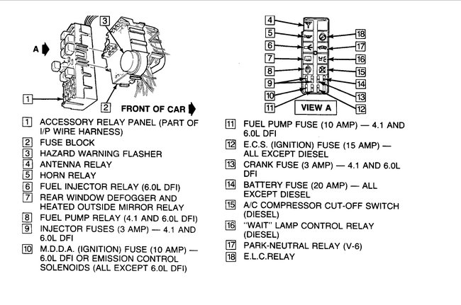

The parts store got me the right one. Thanks. Now how do I find which relay is the fuel pump relay?
Oct 15, 2008 at 8:53 PM
  • 54,128 POSTS
The fuel pump relay is located on relay panel under instrument panel to the left of the fuse box.
