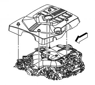

I want to change the spark plugs in my 2006 Cadillac CTS with the 3.6L engine. How do you do it and do you have to remove the engine cover?

You need to remove the shield, as well as the upper intake manifold.

Here is the procedures, the cross car brace mentioned, goes from strut towe to strut tower. If I am correct, your car does not have one.
Fuel Injector Sight Shield Replacement
Removal Procedure
https://www.2carpros.com/forum/automotive_pictures/309872_1469395_1.jpg
Remove the cross car brace, if necessary. Refer to Cross Vehicle Brace Replacement .
Remove the oil fill cap.
Disengage the cover/shield from the ball studs by pulling up firmly on the rear and front of the engine cover.
Remove the engine cover/sight shield.
Installation Procedure
Position the engine cover/sight shield over the intake manifold so the grommets are aligned with the ball studs.
Press the engine cover/sight shield down firmly near the ball studs in order to install the engine cover/sight shield.
Install the oil fill cap.
Install the cross car brace, if necessary. Refer to Cross Vehicle Brace Replacement .
Upper Intake Manifold Replacement

Remove the upper intake manifold bolts. Some deflection of the cowl panel may be necessary to extract the right rear bolt.
Remove the upper intake manifold with the throttle body.

It is really not as difficult as it looks. You may not even have to 'remove' the upper intake, as much as just to move it to access the coils that are in interference. You would still have to do some disconnecting and fastener removal.
