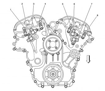

I did a little more research, and I was a bit incorrect on the description. They are listed as Bank 1 Intake sensor, Bank 1 Exhaust sensor, and Bank 2 Intake sensor, Bank 2 Exhaust sensor. Each is respective to the camshaft it is responsible for. If you swapped the Bank 1 Intake sensor with the Bank 2 Intake sensor, the code would have changed from P0343 to 348, and the same with exhaust sensors, the codes would have changed from P0367 to P0392. You are correct in it being the RH side, I have attached an illustration to show the layout. Try swapping the position of the sensors on the RH side only, the expected result should be a P0347 Bank 2 intake low, and P0393 Bank 2 exhaust high. This would confirm sensors. CMP Sensors and CMP Actuator Solenoids
https://images.2carpros.com/forum/automotive_pictures/309872_868189_1.jpg
(1) Camshaft Position (CMP) Sensor - Exhaust Bank 1 (2) Camshaft Position (CMP) Actuator Solenoid - Exhaust Bank 1 (3) Camshaft Position (CMP) Actuator Solenoid - Intake Bank 1 (4) Camshaft Position (CMP) Sensor - Intake Bank 1 (5) Camshaft Position (CMP) Sensor - Intake Bank 2 (6) Camshaft Position (CMP) Actuator Solenoid - Intake Bank 2 (7) Camshaft Position (CMP) Actuator Solenoid - Exhaust Bank 2 (8) Camshaft Position (CMP) Sensor - Exhaust Bank 2
