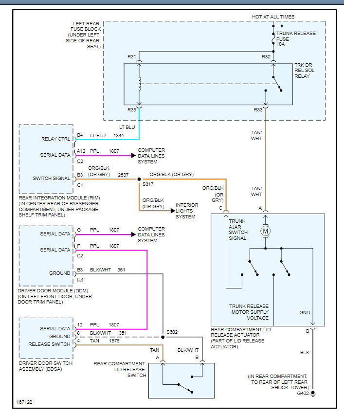

Cannot open trunk with either key-less transmitter or in car trunk release button. How do I repair?

Can you get the trunk open at all? I would check the easiest at first, the actuator on the lid. It might be hidden by a liner held on with clips. If you have and can use a test light, connect it across pins 'A'(tan/white) and 'B'(black). Push the door button and/or fob button, the light should light. If it don't, then check the 'trunk dr release' fuse in left rear fuse block(under rear seat bottom that pulls up). There is a relay(trunk dr rel solenoid) also located in the left rear fuse block. Listen for this to click when trunk switch is pressed. Let me know the progress.

The rear integration module provides the ground signal to control the trunk release micro relay. At the trunk release solenoid connector, The tan/white wire (pin a) should be hot when a request to open is sent. That validates the relay, fuse, and signal. If you have that signal, then check pin B black wire continuity to ground, it is G402 located in the trunk by the left(drivers side) taillight.

As simple as the system should be, it isn't. With what you have done so far, it looks like you only have a few possibilities. Control of the relay is done by the rear integration module grounding it, and that appears to be what is missing. It grounds the relay in response to messages sent to it on the data line, this is where the integration of the key-less path, and the door switch path, is made. You should be able to verify that you have two powers at the relay connector, and then you would almost need a scan tool to read data and see if the RIM is getting a trunk release request. If it is, then you could have a bad RIM, missing power on the control side(which is on the same fuse through a joint connector in the fuse block), or an open ground circuit between the relay and the RIM.

Hi. I have an issue with my trunk release as well. I get the click/voltage change at the relay, but I can not get a test light to work at the rear hatch connector. My thought was that this must be a grounding issue in the wiring between the latch and the relay. Is there anything else I should check before I tear into the wiring? Also, is there a way to remove the LR fuse box in order to check the wiring connection there? I can't find any information on removing it. Thanks.

If you are using a known good ground and probing the tan/white wire, you are not getting power from the relay. If you are getting relay activity, that means the fuse is good, it supplies both the control side and the controlled side. Next you would check the continuity of the tan/white wire to the fuse block terminal R33 if it is labeled.

Thank you for your help in describing each wire's function. I could not find a wiring diagram anywhere so it was nearly impossible to diagnose. I checked the tan/white wire against all 4 spots on the relay and it didn't have continuity with any of them. With this information, I went digging and I found the wire had a break in it in the portion that lies inside the protective plastic cover (not sure how that could happen). I can't tell you how nice it is to have my trunk back after months of having to open using the seat pass-thru. Thanks again!
