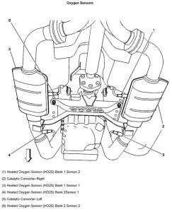

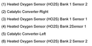

Where are the oxygen sensors located in my car. Not able to fine them.

https://www.2carpros.com/forum/automotive_pictures/12900_o_16.jpg
https://www.2carpros.com/forum/automotive_pictures/12900_o_17.jpg
