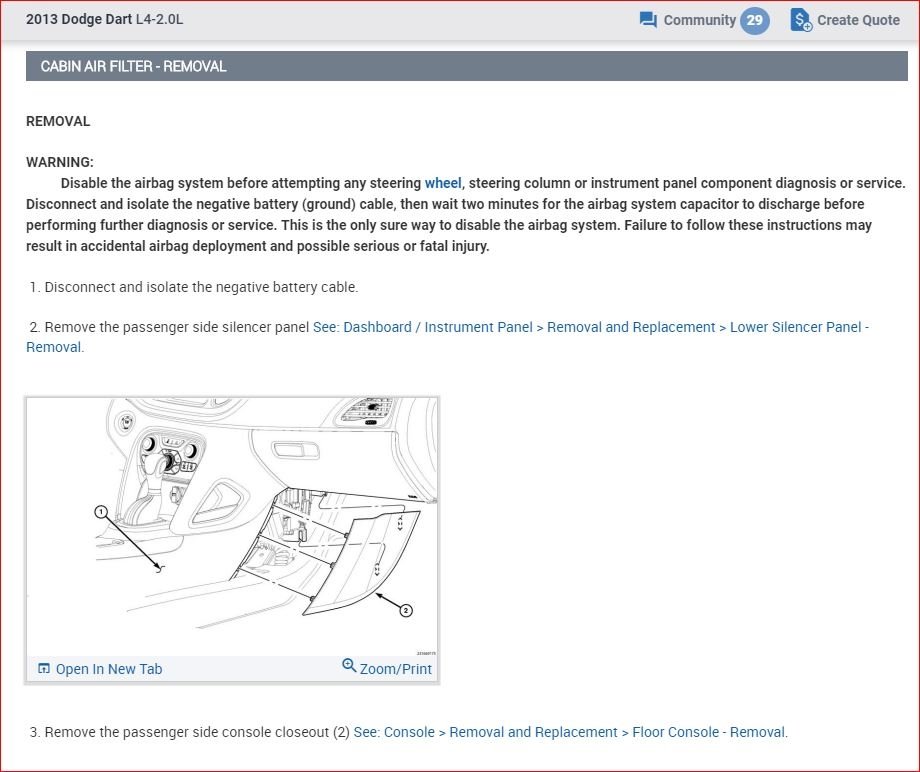

Does my car (listed above) have a cabin air filter?

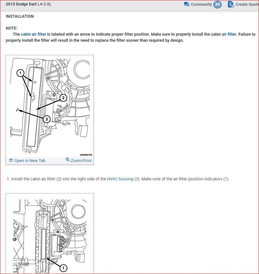

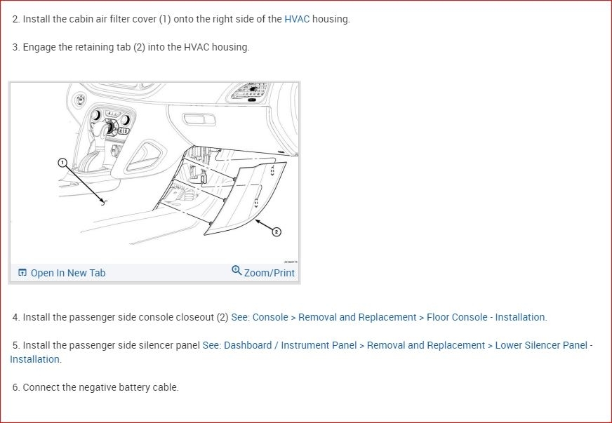

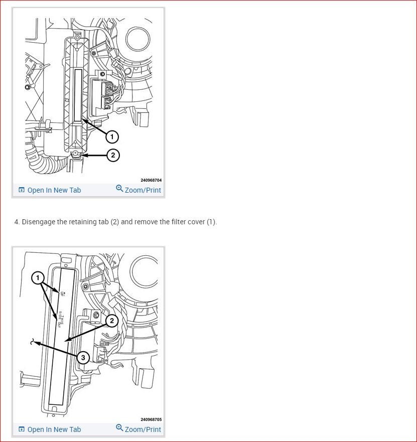

Hi Chuckie,
Yes. It does. Attached you will find the procedure on how to replace it.
Please let me know if you need more information. Thanks
