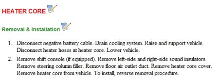

How to remove heater core with air conditioner
Monday, May 17th, 2010 AT 12:15 PM
2 Replies
BLUELIGHTNIN6
MECHANIC
16,542 POSTS
-2
Monday, May 17th, 2010 AT 1:40 PM
