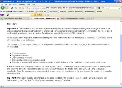

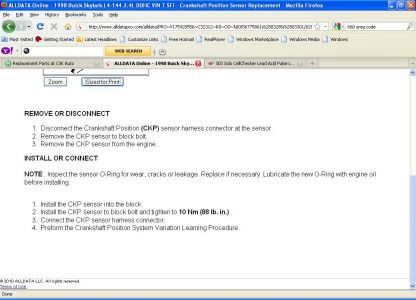

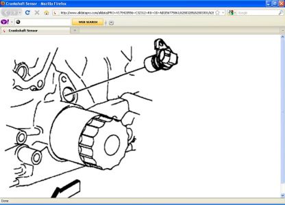

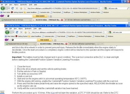

need to know how to replace the crank-shaft position sensor on my 1998 buick skylark with a 2.4?(Total procedure)

There you go.
