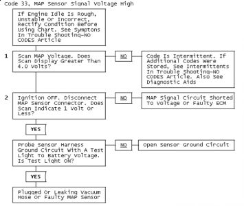

Hello.
How to fix a DTC-33 MAP sensor error?

Follow the troubleshooting tree below to pinpoint the cause of this trouble code.

It was just a broken depression hose.
Thanks for your help
