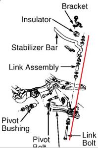

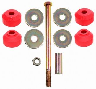

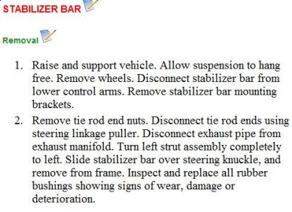

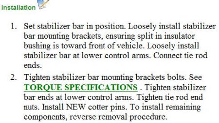

How do you install a stabilizer link. Can I get a picture of how to do it.
