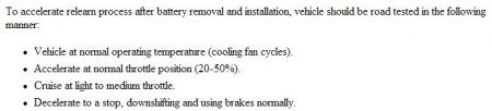

How do you reset the computer after the battery has been unhooked
Sunday, February 28th, 2010 AT 7:38 PM
BLUELIGHTNIN6
MECHANIC
16,542 POSTS
Vehicle's computer will relearn itself after several ignition cycles of the key. below are some steps to speeding up the relearn process..
