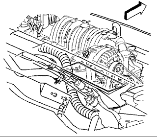

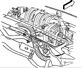

The belt tensioer broke and was wondering how hard it is to replace with new one?
Monday, February 1st, 2010 AT 4:46 PM
  • 75,992 POSTS
2001 Buick LeSabre V6-3.8L VIN K
Removal Procedure
https://www.2carpros.com/forum/automotive_pictures/12900_dbt1_1.gif
1.Drain the cooling system.
2.Remove the generator.
3.Remove the heater hoses from the drive belt tensioner fittings.
https://www.2carpros.com/forum/automotive_pictures/12900_dbt2_1.gif
4.Remove the drive belt tensioner bolts.
5.Remove the drive belt tensioner from the engine.
Installation Procedure
https://www.2carpros.com/forum/automotive_pictures/12900_dbt3_1.gif
1.Install the drive belt tensioner to the engine. Notice: Refer to Fastener Notice in Service Precautions.
2.Install the drive belt tensioner bolts.
*Tighten the drive belt tensioner bolts to 50 Nm (37 ft. lbs.) .
https://www.2carpros.com/forum/automotive_pictures/12900_dbt4_1.gif
3.Connect the heater hoses to the drive belt tensioner fittings.
4.Install the generator.
5.Fill the cooling system.
