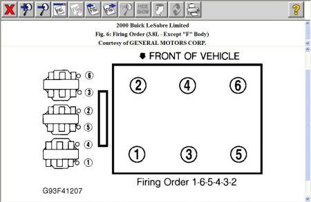

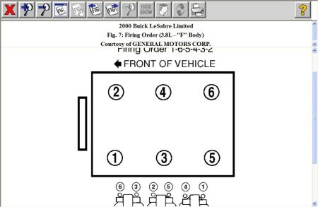

I was at a diagnostic center & they told me I had to change the coil for spark plug #4. Ea coil has 2 plug wires on it, both on the right side! Without getting under the car & tracing the wire, which coil is it? Top, middle or bottom?
Tuesday, March 25th, 2008 AT 3:12 PM
11 Replies
  • 75,992 POSTS
See below pick your type
https://www.2carpros.com/forum/automotive_pictures/12900_fo1_1.jpg
https://www.2carpros.com/forum/automotive_pictures/12900_fo2_1.jpg

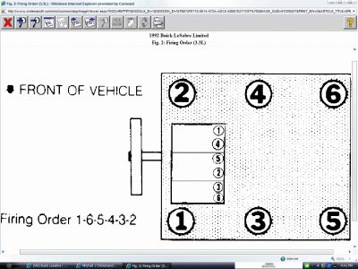

I need the firing order and which cylinder is which
-1
Saturday, November 14th, 2020 AT 5:00 PM (Merged)
INTERNETMECHANIC
  • 700 POSTS
Not sure which engine you have? This info is for the 3.1 L engine.
https://www.2carpros.com/forum/automotive_pictures/512072_buick_lesabre_31_firing_order_1.jpg

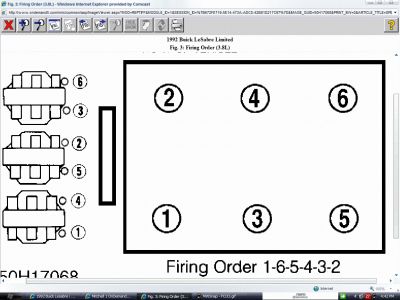

What is the firing order and cylinder location of 3800 92 lesabre
+1
WRENCHTECH
  • 20,761 POSTS
Type one system
http://i1198.photobucket.com/albums/aa448/Wrenchtech/92717857.jpg.gif
Type two system
https://www.2carpros.com/images/external/92717856.jpg.gif

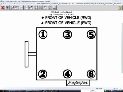

Depends which 6 you have?
https://www.2carpros.com/forum/automotive_pictures/62217_FO_6.jpg
This is for 3.1 and 3.4
https://www.2carpros.com/forum/automotive_pictures/62217_FO33_1.jpg
This is 3.3
https://www.2carpros.com/forum/automotive_pictures/62217_FO38_1.jpg
This is 3.8....

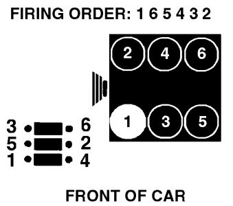

Engine Performance problem
1991 Buick Lesabre 6 cyl Two Wheel Drive Automatic
can you provide the diagram for the plugs and wires to the coil pack for a 91 buick lesabre? I changed the coil pack, and modulator and the car is not running correctly. It is constantly cutting of, and sputtering, which it did not do prior. Both the modulator and coil pack are new, not used.
WRENCHTECH
  • 20,761 POSTS
https://www.2carpros.com/forum/automotive_pictures/561653_Firing_order_91_38_1.jpg
