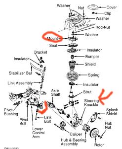

I hit a large bump in the road last week. Took it to Sears the following day. They did an alignment (4) wheels. No change. The vehicle wanders and must be constantly corrected. I know that the Lesabre has only one drive wheel (left front) and it torques to the left, but this is different. It wanders to the left, I correct to the right. It wanders to the right, I correct to the left and this goes on forever. The steering wheel is cocked to the left, very slightly and when I make a turn, the wheel doesn't want to return to the straight forward position.

Normally it sounds like an excessive toe-in problem, hopefully put a real alignment tech on the job that day. I assume the tires are good.
The upper strut mounts or ball joints may be binding bivng it memory steer. Get the front end in the air and see if the wheels will move in a turning motion reasonably easy.

Have them check very closely at the lower control arms and the rear bushings on the control arms. IF you whacked it hard enough one is probably bent.

Well my logic is that the potential binding would be related if it forced the control arm back.
https://images.2carpros.com/forum/automotive_pictures/30961_les_1.jpg
The tow points of attachement are the strut and the ball joint....hopefully the spindle is alright. If this is the case, I would expect the stab links will need replacement as the usually don't come off..at least here in the north east US
