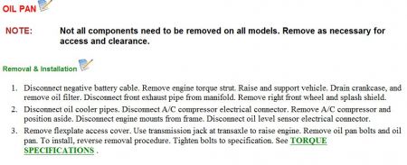

How many hours does it take or log to replace a leaky oil pan gasket?
does the motor mounts need removed or any other operation to replace the gasket?

See text for removal procedure this should take about 1.5Hrs.
