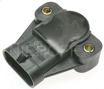

Where and how would I replace the Throttle Position Sensor on my 1993 Buick Lesabre.
Sunday, March 8th, 2009 AT 9:32 AM
ZACKMAN
MECHANIC
4,202 POSTS
It is in the throttle body assembly. Looks like this.
Disconnect the electrical connector and 2 screws, and reinstall.
