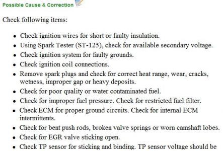

When I try to accelarate my car hesitates on the highway.
Friday, March 27th, 2009 AT 5:06 PM
ZACKMAN
MECHANIC
4,202 POSTS

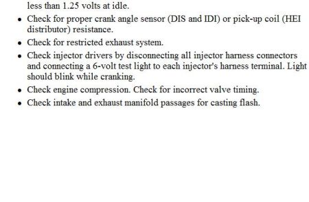

There are many possibilities to your description. Here are some diagnostics for high rpm miss.
